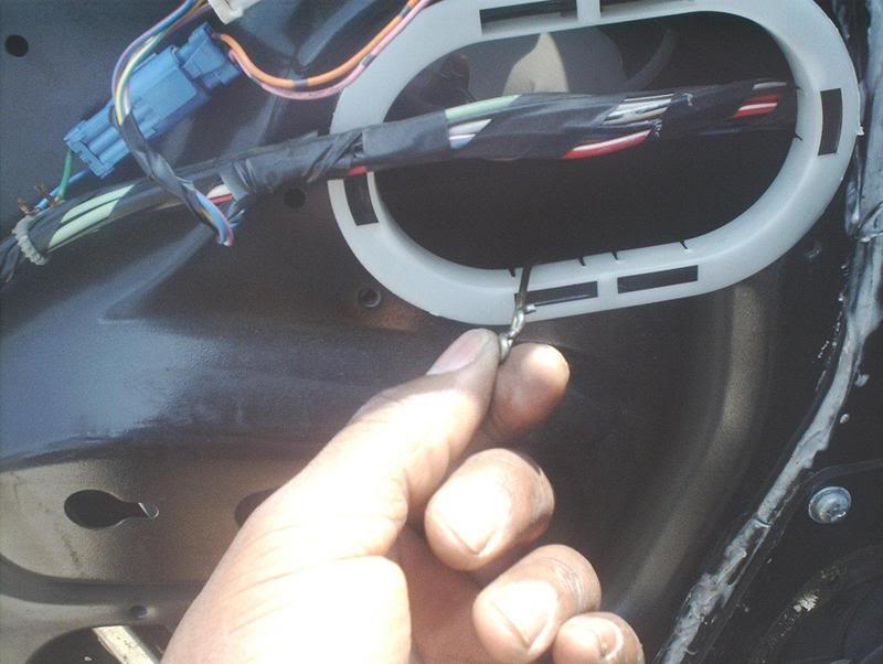

It is tight in there but I just ran new wire through that boot. I pulled the boot on the car side to expose the wire. Took a hanger and taped the wire to the end of the hanger I put in first. Fed the wire through the door, in through the boot until I saw the end coming through the side of the boot that I pulled off. Separated the wire from the hanger and just manually fed the wire down into the car. Eventually it will reach the floor. I just did this yesterday when installing my folding mirrors.
You've probably already done all this but make sure your windows are down, makes it a lot easier to spot the wire while looking inside the door. I took the straight wire and sorta bent it at a 35 degree angle and inserted it through the rubber grommet. If you push it straight in it will go behind the lowered window so you have to turn it slightly so that the bent section passes in front of the window. The goal is to get the coat hanger as close to this oval thing
as you can so you can reach in and grab it with your hand. Then, while looking through the oval, manuever it as close to the opening as you can. That oval is pretty big so you can get your hand in there a pretty good distance so you won't have to get the wire in that far before you can grab it. Also be careful not to scratch up your window by tugging on the coat hanger. Let me know if this helps.
im using thicker wire...where the 2 pieces are still stuck together...looks like home speaker wire and i think it is. maybe if i seperate the 2 to give me a bit more room it will make my life easier..i'll keep you posted. thanks guys
